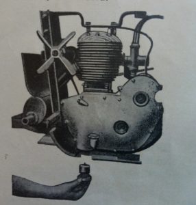

je suis nouveau sur le forum je cherche des connaisseur en motoculteur energic pour résoudre mon problème.
il y a 2 ans j'ai effectué la restauration d'un energic D9. Celui ci fonctionne le moteur tourne très bien et démarre  au quart de tour ,mais le souci c est que l'huile qui se trouve dans le bas moteur ne remonte pas dans le réservoir qui se situe a coté de celui de l'essence du coup elle devient très chaude rapidement .
si quelqu’un a une réponse a mon problème je prens ??????

Bonjour antho84
That the return pipe at the top of the engine (frotteur de retour) is clear and unblocked. At its exit point from the engine through to the entry point into the oil tank. Normally there is a weighted perforated sleeve over the entry pipe into the oil tank because of the pressure of oil circulating back to the oil tank.
The ball bearing in the oil float valve (flotteur) at the bottom of the engine moves freely. This regulates the circulation of the oil in the moteur. There are 3 settings on the Pointeau attached to the flotteur for regulation of the quantity of oil in the engine from the return valve. These are normally set by the factory and normally not altered.
Also if the oil floater valve has removed and not replaced correctly. That is it is not been seated correctly into the carter, not offering the pointeau in the correct position, then this will also effect the flow of oil.
Do you have enough oil in the oil tank to get a return flow? You should have 2/3 to 3/4 full with the engine at rest. Not higher than the top of the evacuation pipe to the chain
The previous model C7 4BL and D9 5BL had problems with over heating due to the lack of volume oil circulation with a smaller vertical reservoir, so the S bloc models moved to a larger capacity tank and a float system.
see the following page on my web site   http://energic.info/engines/fuel-fuel-tanks-and-oil-tanks
Jon
Hope that this is of some help.
