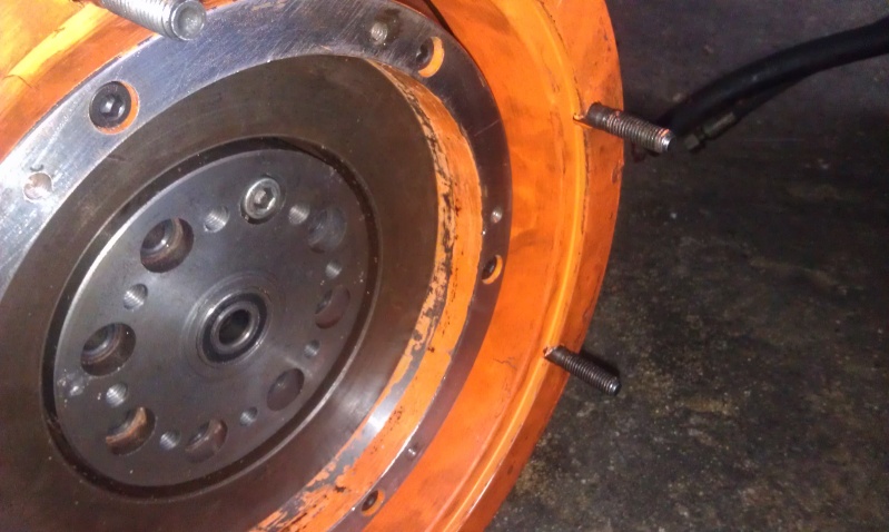

| Good morning to all (Bonjour a tous !) Although I used the Lombardini 11LD 636-3 in the Goldoni in parallel I started looking for solutions in order to repair the old Slanzi DVA 1750. The progress is this subject is quite impressive!!! I found an old Slanzi DVA 1750 for ONLY 330 Euros (I bought the engine 80 Euros + 250 Euros for the transportation from Czech Republic to Greece !!!!!) I bought the engine having in mind that it is impossible to work and I could use the crankshaft, but when I tried to start the engine just from curiosity I was really surprised ………. The engine works !!!!!!!!!!! So, my friends now I have 2 engines for my Goldoni !!!!!!!!!!!!!!!!!!!!!! Of course I will continue to use the Lombardini since it is better but it is not bad to have a backup !!!!!!!!!!!!!!!!!!!! Regards, Constantinos | |

| Dear François The hole idea was to replicate the Bellhousing of the Slanzi in order to use the same clutch and the same primary shaft of the gear box. I made 2 parts. This because the flywheel of the Lombardini was flat as you can see in figure 1. Figure 1: Flywheel of the Lombardini. The 1st one was to fit the clutch, as you can see in figure 2. I did not drilled the clutch. Figure 2: The first homemade part to attach the clutch. The second homemade part was to adapt the engine’s bellhousing to the tractor’s bellhousing since the dimensions ware different in diameter. The Slanzi had SAE 5 bellhousing while the Lombardini had SAE 4. That means that the diameters are different. This homemade part is seen in figure 3. Figure 3: Second homemade part. You are correct, the primary shaft of the gear box goes inside the bearing. That bearing was in the Lombardini, so I used it. Otherwise I had to made it from scratch, since the primary shaft should lie on a bearing in the flywheel (as you can see in figure 4). Figure 4a: Bellhousing of the Lombardini. Figure 4b: Bellhousing of the old Slanzi. As you can see from figures 4a and 4b the bellhousing are the same. I have not checked the engine cover yet. As for the other Slanzi, 1st of all it works, secondly, there are too many parts that are exactly the same in all 3 engines that I have (11Ld626/3, 1750 and 1550) !! I hope that I helped, but if you have any question please ask. Best regards, Constantinos | |

When you wrote that the bellhousing are different (SAE 4 & SAE 5), these differences are only on the external/internal diameter and the shapes (round shape on the slanzi bellhousing and nearest of a square shape for the lombardini's one).
It would appear the threaded-rod position are the same, that it permits to fit directly the lombardini bell into the slanzi tractor's bell. This on this point that I have a doubt, I believed it was not possible that the positions were the same in terms of diameter and angle.
Could you indicate the height of these 2 home-made parts ?
I guess you use new threaded-rods that are longer than the original ones.
Best regards, François | |
| | | kangelis
Nombre de messages : 62 Age : 55 Localisation : Arta, 47100, Greece Date d'inscription : 21/05/2013
| Sujet: Re: Goldoni 240 Universal Lun 16 Déc 2013, 07:11 | |
| Dear François, You are correct, the differences are on the external/internal diameter, while the shapes (round shape on the slanzi bellhousing and nearest of a square shape for the lombardini's one) aren’t of interest. The Lombardini’s bellhousing was 1 cm shorter in diameter if I remember correct and consequently the threaded-rods diameter, while the positions in terms of angle ware the same. So, in order to fit the lombardini bell into the tractor's bell what I did was to drill down the tractor's bell. If I remember well ( I can measure in detail when I’ll be in the garage) the height of those 2 parts was 2.6 cm for the first one and 4.0 cm for the second one. And of course I used longer threaded-rods.

| Works been made a few weeks ago: Fixing the clutch and tires, with the help of a colleague and friend of mine. Now I’m waiting for the holidays in order to finish with the mechanical issues which are basically: 1. To add the old or a decent hydraulic pump 2. To fix the basic electric wirings 3. And to change the engine oil, gearbox oil etc… | |
